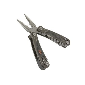

I ended up not being successful with the rubber band on the tip of the pen... instead I used the middle section of these pliers with the teeth that bit the pen up bad. Then wrapped the shaft with rubber bands and twisted like there was no tomorrow. it basically ruined the looks of the tip so I filed the burrs with high grit sand paper so it would be smooth again.

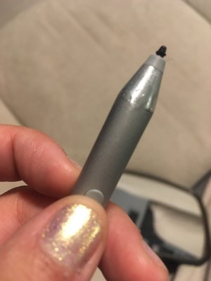

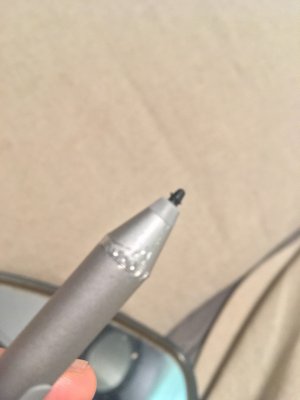

For me, it did scratch up the pen quite a bit, but to be completely honest, it was either this works in fixing it, or it was going in the garbage. I couldn't get but maybe 5 min of pen working in between 20-30 attempts; I hadn't used the pen in months just for the fact that it infuriated me how it would work for a few minutes then just quit for no apparent reason. Unscrewing cap.. new batteries.. nothing else seemed to work.
