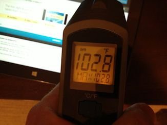

Do you have a Non Contact Digital Infrared Thermometer Gun? That would be very accurate. I would imagine it's hot while the battery is charging, then after fully charged and plugged it cools off.
This is front side ... about 1.5" from top and 2.5" from right edge of screen. RUnning on battery for approx 20 minutes - just IE and MAIL apps open
That's just 39 °C, that I wouldn't be concerned. Typical operating range for laptops would be around 36 °C to 60°C.
