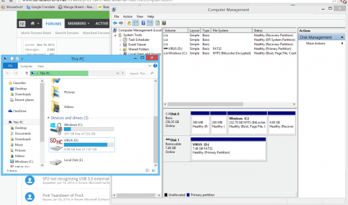

it shows up on my file explorer but not disk management
Screenshots???? How does it show up in Explorer?
