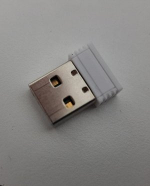

The HDD is not working when connected to the hub (and the hub to the surface); the mouse and keyboard are connected through a small USB device, the one shown in the attached picture, that's why I am trying to connect them both through a hub.
