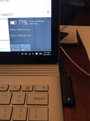

A worse problem is my SB sometimes doesn't charge from the dock. For the last couple of days I've left the SB connected to the dock and I noticed yesterday when I was working that the batteries were running down and not charging. All my connections were fine - I could access the USB drives plugged into the dock, the computer audio was sent to the dock audio port and I can sync my iPhone and iPod through the dock, but no power! I thought it might be my power supply so I turned the power supply switch off and back on, and after disconnecting and then reconnecting everything plugged into the dock the SB batteries now showed they were being charged. But this morning I awoke the SB and once again I see that the batteries are being drained and they are not charging, as you can see in the attached photo.

With Respect To not charging the SB. I hit this one too. I needed to power off and on the DOCK. That one REALLY p'd me off as I ended up with a low battery that I was not expecting.
