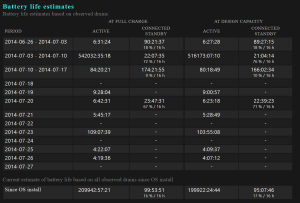

I need to calibrate whatever reports the remaining battery percentage. Basically my reported battery life drops really really slowly down to about 82% (after several hours use) and then drops like a stone with the machine switching off with no warning. I've run the battery report utility:
powercfg /batteryreport /output %USERPROFILE%\Desktop\battery_report.html
and attached a screenshot of the report - you can see the numbers are completely off the wall!
