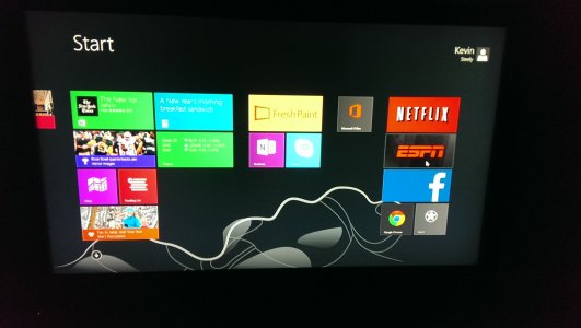

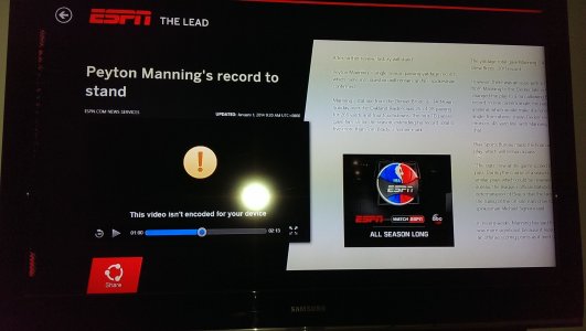

When connected to the TV, it seems to work beautifully. However, there are screen artifacts on certain applications and always when viewing video on the device. I've attached a couple of screenshots. The main screen has no visible artificats. The ESPN app has a ton of red artifacts on the left side of the screen and all video files have the artifacts as well (although not as noticeable as the ESPN app).
Next, when I do certain things on the device, the TV loses the signal. For example, clicking on the down arrow to bring up the list of applications, the screen resolution seems to change (flickers for a second), shows the applications with terrible red artifacts everywhere, and then the TV loses the signal. Also, If I go to Settings->Change PC settings the screen does the same thing. It flickers for a second, you can see the settings screen for 1-2 seconds, then loses signal. When I hit the windows key on the keyboard, the screen comes back on to the default landing screen. Hitting ctrl+alt+del to bring up task manager will also force the TV to lose signal.
