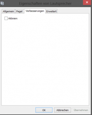

I've read that in the 'audio enhancements'-section of the speaker there should be some options to check/uncheck. However, I can't find anything of this.
The audio-enhancement panel looks like this (NOTE: the 'Aktivier' behind the checkbox is uncomplete. I assume that it should be 'Aktivieren' (engl.: activate)):

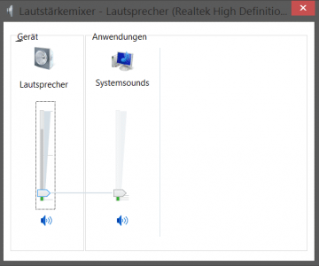

Also the volume level of the source (or whatever the grey bar behind the green bar should stand for) seems to be really high:
this is a screenshot from just setting the sound volume (to 7) to get this 'pling'-sound. The grey bar from 'Lautsprecher' hitted the top. This isn't normal. It appears to me, that there is somewhere something active like a amplifier. It also looks like a software problem, because of the grey bar that is hitting the top.

'audio enhancements' was checked too at the beginning, but I unchecked it, to see if there are any changes (there were no changes). This 'audio enhancements' tab isn't also unavailable on the headphones, so I do not think, that that causes the problem. Are on your surface more things under the audio enhancements tab?

EDIT: Could be a driver problem. I've selected 'use old driver' on the properties window of the relatek chip. After that, the windows sound (e.g. the 'pling'sound from volume control) was fine. Could set in on 100 and it was like it should be (the grey bar in the mixer was not hitting the top)
I plugged in my external speaker. A window popped up which was saying, that the audio jack will be installed. So, the driver installed itself again. The result was, that the sound on the speakers was as loud as before.
After I restarted the surface everything was broken again. Windows sounds were to loud and the grey bar in the mixer is hitting the top again...
EDIT 2: Resetted the Surface completly. Only created a new user account. First thing I did was to check the speaker volume of the surface. It was still too loud. So I deactivated the audio-enhancements. Although the enhancements were deactivated before too, the grey bar didn't hit the top and the sound semmed to be normal, even after reboot. However, the sound over the audio jack is still too loud with media player on 4 and volume on 20. (with external speakers/headphones the grey bar isn't hitting the top either, but it also wasn't hitting the top before reset.)
Someone could please check how high the grey bar behind the green bar in the audiomixer is going up (e.g. when you are setting the volume to another value so that this 'pling'-sound appears) and if the audio-enhancements are activated or not?
