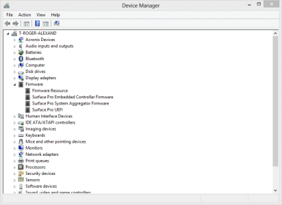

What does the firmware in device manager look like? Is it waiting on a reboot?
My surface displayed "strange" behavior until I got that sorted out. I had to choose the device and properties and issue the reboot from the driver screen there to get it to take.
