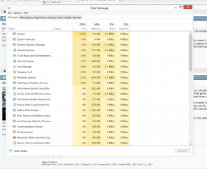

I have two rather major issues with my Surface Pro 3. At idle, system and system interrupt is taking up a good amount CPU power for no reason looking in task manager. My system is idle yet the fans are screaming and the back is hot. I see the Surface Pro 2 had this problem (threads on this forum) and now it seems its back again?

Oddly, as long as I don't have a mSD card inserted when I boot, I don't have the System/System Interrupts bug (~20% CPU usage), but do if I insert one, and it stays active even if I eject until I shut down.

Here's a snapshot of mine when it's doing it, totally idle, system should be sitting quiet and cool, yet it is burning up, fans blasting, wasting battery... this is with a mSD card inserted, I've yet to see this happen when I've booted up and kept the mSD card out of the device:
