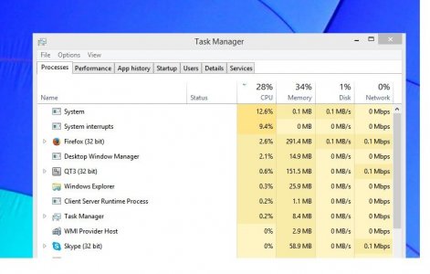

I upgraded today and this is the surprice, yesterday was not doing it, today I used a micro sd usb device just to transfer 2 files I needed over 1 gb, and I removed it now.
I read around the web who had same issue with audio tests, etc etc but nothing to do.
I have Sp3 in the docking 3 right now.
Please help, with Cpu at 33% and more all the time I need to shut down the system because not able the fan to handle this bug..... I can't believe, no luck yet with Sp3.

I try to clarify. This is not happened just after I did the transfer. I know that in those cases the system resources make the cpu load high. Since this morning the load of cpu was 20/25% constantly, always, even if I was not doing nothing, but because I had to test my trading softwares, with them plus firefox I arrived easily to 35/40% so the sp3 get hot in few minutes and fan always on at quite high speed.
I have read that many users are experienced this issue, and because this overheat may be that who has overheat problems and have not checked the taskmanager do not know about those 2 system/system interrupts that are causing this.
Because today surfing I found a person that said that removing the docking it stopped, I did it, and in fact now that 2 lines are disappeared from taskmanager and not caused the cpu overload for nothing.
