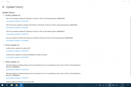

Okay, this is my update history. Does anything look suspicious here?

Somebody else smarter than me will have to help with that but you can right click on Display Adapter and scan for hardware.
