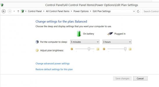

I've been using the S3 to play Spotify in the last couple of days to a Bluetooth speaker, whilst leaving the S3 plugged in some distance away. And it keeps sleeping after a few minutes - so I adjusted the sleep settings when on power to 3 hours - and it makes no difference, the S3 just seems to ignore the setting, even after restarts etc. Anyone else see this, or found a resolution?

hughlle has it correct. To work around the machine sleeping whilst playing to a speaker outside, I set the sleep when powered to 3 hours. It doesn't work, it sleeps - or, at least, the screen goes black and Spotify stops playing - after (oddly) about 15 minutes. The display off, I note in the advanced power settings, is set to 180m (after absorbing what you posted about display off/sleep amounting to the same thing on the S3).
I wonder if this could be anything to do with the security settings imposed by my connection to work Exchange server. Regardless, I can't see this is anything less than a clear bug: If the secutiry constraints are anything to do with it, I shouldn't be able to select the settings I have, in the same way that I cannot deselect the 'require a password from the lock screen' setting (it's greyed out)

Exchange Active Sync Policies can in fact override all local policies, and with a Connected Standby device on Windows 8.1 screen off=S0iX Connected Standby...

Yup this is your Corporate policies. If I have mine on EAS or the domain it does the same. I had to make a collection in SCCM and in AD to keep it from happening.

EAS has Power Management Policies as well as Security Policies (Such as "Screen Off after...."). Most of the MDM/MAM Solutions used today hook into these EAS Policies. On a Connected Standby enabled machine screen off=connected standby....
