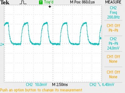

today I did a small measurement of the Background light of the Surface pro 3 (sometimes having a Bachelor degree in physics is actually useful :P)
With lowest brightness settings, we can see how the LEDs are only switched on for a short time (F0005TEK)

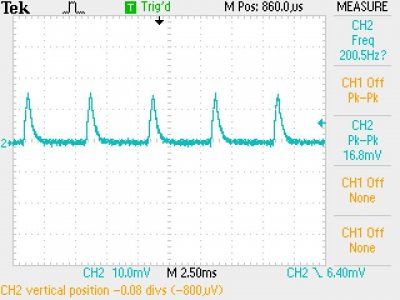

The next picture shows the behaviour of the LEDs at around 25% brightness (F0006TEK)
The frequency of on/off is around 200Hz, which is a little bit low.

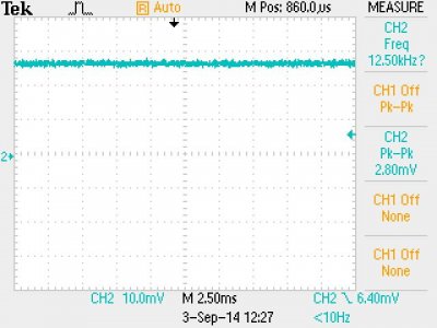

Starting at around 55% there is now PWM dimming anymore (F0007TEK)
So you should be fine with using the SP3 above those 55%.
