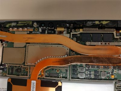

Well, I'm am in I similar situation. We had a SP4 and it was flickering during Team's meetings. Can't say if the screen replacement will fix it but it should. Might as well replace the ribbon cables as they are only $10ish each. I had read that the screen getting too hot but another post said the ribbon cables are getting too hot. I plan to add some thermal resistance tape to the ribbon cables just cause it a headache to open this thing.
If you do open it up, I'd would replace the thermal paste while you are in there. The SP4 we had a crazy amount of it so it seemed to be more an insulator then anything. It runs way cooler now. I'd like to also say be super carful around the middle of the surface with the wifi when taking the screen off. Don't use a spudger here or anywhere really. I thought I botched the wifi but it works.
Side note: I thought I had got the right screen but it seem I may not. What are you going off of when buying one? I also could of also been too rough with the digitizer connector as my old splintered screen no longer works now. XD
