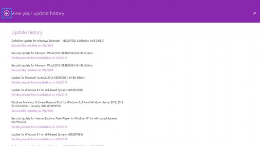

If I ever hear the question on Jeopardy, the one thing Mississippi and the UK have in common, at least now I know what the answer is.
Judging from that image, those updates are the Super Patch Tuesday Windows updates Microsoft rolls out every month. Those are general Windows fixes, and not specific to the Surface.
Thanks for the clarification. I can feel good about rebooting now. :)

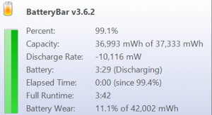

Still have problems after the firmware update, specifically the 'lost battery capacity' issue (looked fine until I performed a reboot, at which point it dropped from 42K to 37K). Verified also with powercfg:
On the plus side, didn't notice any sleep or battery drain issues overnight which is certainly better. However, definitely not a full fix for me :-(

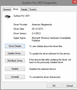

Edit: While the update definitely updated something FW related (as indicated by the boot screen after updating), device manager still reports that the old UEFI is present (same applies to all other firmware resources). Not sure that's relevant, but odd nonetheless. Maybe the update itself has been broken up and released in waves ;-)
