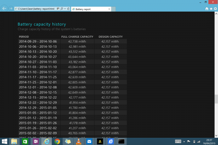

how is this even possible my battery showing more capacity then the design capacity pic attached mines the LCE battery

Doesn't surprise me.. I am now convinced the LGC battery in the SP3 is far superior than the simblo
1,000 charge cycles is what some manufactures say is the standard for Li-ion batteries. 57% at 500 sounds like it's close enough.
Actually that's quite common batteries are built a little over capacity to avoid complaints of being shorted.

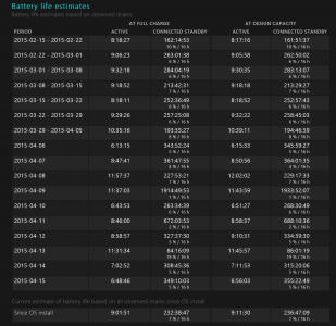

I have an LGC battery too with 31 cycles and I'm averaging just over 9 hours with brightness set to 30% and 70% when plugged in. Brightness is the biggest factor with battery life; if I set the brightness to 50% or more, I'll average 6-7 hours of battery life. If I set the brightness to 10% or 20%, I'll average 10-11 hours.

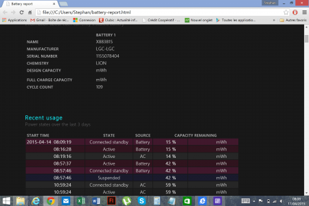

Any idea why I can't see some information in the battery report ? (like the remaining capacity, the design capacity, full charge capacity..etc)
Well, actually I don't consider 57% to be anywhere close to 80% as MSFT claims for 1000 cycles. Of course, I'm making a huge assumption that my battery will lose its capacity at the current rate which is 3% at 35 cycles.
