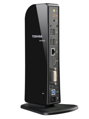

I just ordered this on Amazon:
Toshiba Dynadock Docking Station
Amazon.com: Toshiba Dynadock Docking Station (PA3927U1PRP): Computers & Accessories
Seems pretty cool. It is one docking station that plugs into your USB 3.0 port and allows you to run everything, including up to 2 external monitors, external speakers, ethernet, headphones, microphone, up to 4 USB 3.0 devices and more. Pricey at $130 but if it works worth every dime.
Sit at your desk, attach one cable and you are good to go.
* Will update post once I receive it to say if it works as advertised.

Thanks for the input guys. Got it, sending it back and here's why.
The HD 4000 Control Panel does not recognize the external monitors hooked up through this. That means you can't use the excellent color calibration tools and especially gamma adjustments available from Intel. My monitor just looked washed out. Everything else works fine but so would a $40 USB 3.0 hub.
Close no cigar.
P.S., Toshiba's Tech Support for Peripherals such as this is so laughably bad I almost don't know what to say about it.
