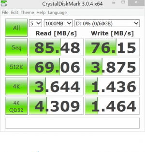

Does anyone know if the sd card slot is able to reach 90mbs write speeds if used in conjuction with a 90mbs micro sd card?
Didn't make it, only 76.15 MBps With Samsung 64GB Pro.
