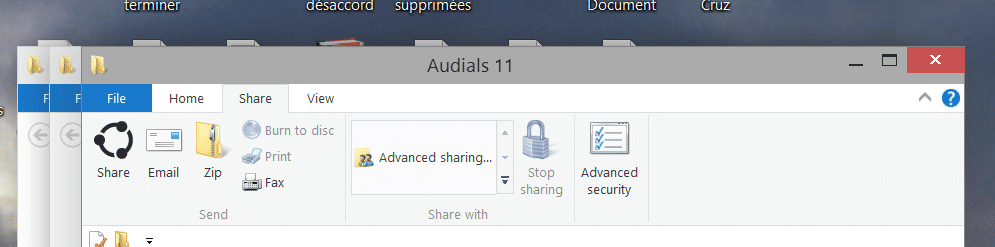

Are these options new in W10?
That is not new - it is the "Share" options. These options are available on the keyboard (F6 key) and Charms (second from top), and are in the context of the Window or app with focus when Share is invoked.
