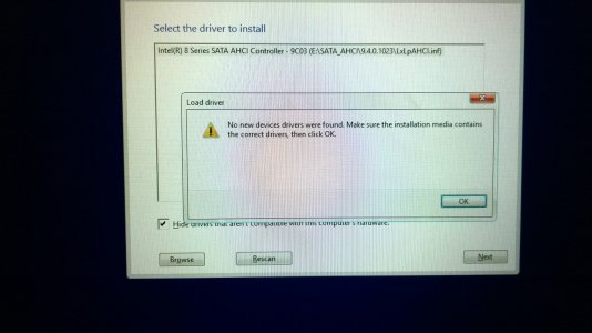

It shouldn't need a driver for the SSD as it is a SATA Interface, you can download the SP3 Firmware Update files from January and add the driver....
http://www.microsoft.com/en-us/download/details.aspx?id=38826
The Driver would be found in this path:
\Surface Pro 3 - January 2015\Surface Pro 3 - January 2015\Intel\SATA_AHCI\9.4.0.1023\
Thanks, I did select those drivers in the beginning and they showed up in the selection but for some reason it would not accept them, but will try again
*****update ****
tried again but no luck, does anyone have any suggestion
*****update ****
You could try to 'force' it. Untick the box which says to show compatible only, and then manually select from any list of drivers it shows you.
Also I just read your other post about the drive not showing up. You can check in Disk Manager to see if it is actually recognised by the system. If it is recognised, but not properly allocated or does not have a drive letter attached, it won't show up in your File Explorer (or command prompt).
HI
Thanks for your input, think I did try that, but will have another go, the hard drive is my main hard drive so everything is present and correct, it's just when I try to install window from fresh there are no hard drive to select but presume this is because it can't find the driver for the controller, But can't think why

Ok another update, recreated the bootable windows image on my USB drive using a programme called Rufus and that seem to do the trick, all the partitions are now showing.
Big thanks for all your help and suggestions
