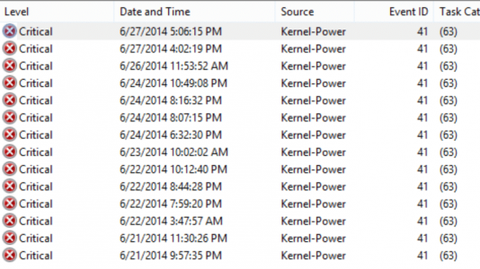

Hey guys so up until now I been thinking my issues are all software based and updates would resolve. But I am still getting random reboots..
I wonder if it is related to the wifi issue because many happen upon wake up.. I think it comes on but then the Surface logo is there.
: Untitled.png
What do you guys think, hard ware issue and time for a swap or software and wait it out?

Just for comparison, I've had my Surface Pro for six days I have not once received the Kernel-Power error. Additionally, the computer naturally will show the "Surface" symbol when coming out of Deep Sleep (which kicks in anywhere from 2 to 6 hours while in sleep mode)
ipaq_101
Same here, I have never seen that error before.
Did you do any of those rollback drivers? Maybe that had something to do with it.

I would do a full Factory Reset first, and if that doesn't clear it up then I would return it...

Was up late finishing up the build. I just did the firm ware update last night.. I will try this part now.

Wow... went from 72mbps now I am getting 243! Let's see if it stays steady. Thanks guys. I'm happy I swapped out the unit, this thing is running very nicely.
