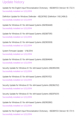

Unless I'm reading the list wrong (6th one in the list) mine says Firmware...

That is the Firmware, and that looks like last Tuesday's Updates as well, there was another Update I received today for System Hardware..

You have just done a refresh haven't you. Seems to be re - applying everything that you already had before the refresh?
I didn't think about that. But I didn't think a refresh would remove updates and firmware updates!
