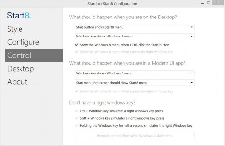

I also recommend you download Start8 which is a little app that gives you back the Windows 7 Start Button and also more control over what your extended screens do. Also if you are running the latest HD 4000 Control Panel it turns some hotkey stuff as far as screen rotations etc on by default. They are kind of weird and can interfere with Windows 8.1 hotkeys. Just open the HD 4000 Control Panel, go to Settings and turn the hotkeys off.
Here's some of the control Start8 gives you:
