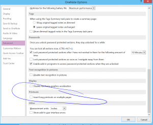

Try unchecking this. It slows down adding PDF's and is also aggravating, IMHO.
@the1spicymeatbal thanks dude, I did this, through my PC, and OneNote was only constipated for like like 2 minutes and then pushed out a PDF. Now if it will sync with my SP3, I will be set.
