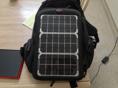

EXCELLENT!! ok, here is the pack in question:
it is a voltaic systems "array." here's a link to the product page with specs. I guess the first thing to determine is whether the specs of the pack are sufficient to power the surface pro. I'm not sure what the surface pro's power requirements are, but since this charges my macbook air, I would assume it will work.
Voltaic Array Solar Laptop Charger

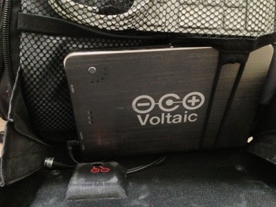

here is the actual battery pack that the solar panels charge

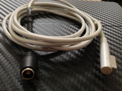

this is the magsafe cable that charges the macbook. now what I don't like about this cable is it terminates to a certain end that doesn't connect directly to the battery. it plugs into an adapter cable then into the battery.

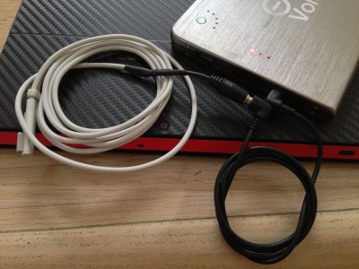

so this is how it actually connects to the battery pack.

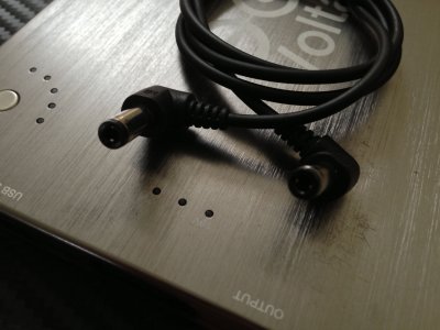

and finally, here's a close-up of the adapter cable.
