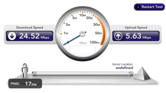

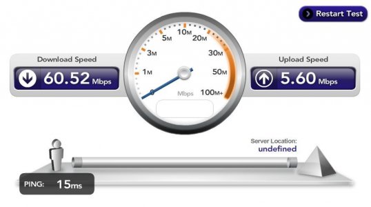

UPDATE**: We seem to be getting mixed results on this from various people. It could be that this is a problem specific to certain bluetooth devices. In my case I am using a Microsoft Sculpt Touch Mouse and it is clearly an issue as you can see from the following pictures:
Mouse Off:
Mouse On:
Mouse Off:
Mouse On:
