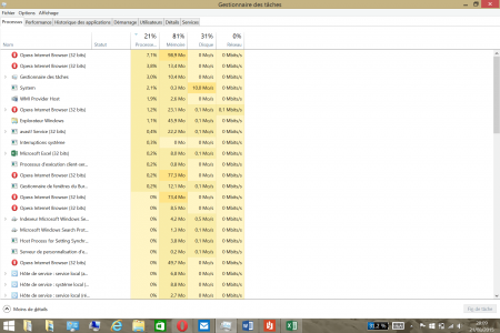

I give also screenshot of my task manager. It is in french but I think that you can say to me what are the pointless process
>Task manager 1 http://dl.free.fr/getfile.pl?file=/a6VgN4cy
>Task manager 2 http://dl.free.fr/getfile.pl?file=/TSTWvPfw

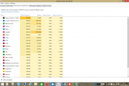

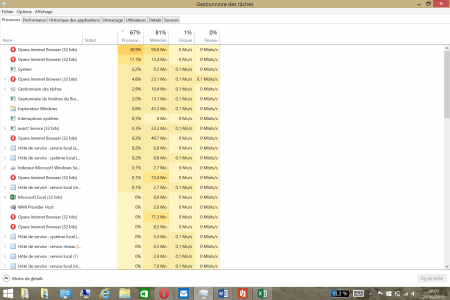

The energy report and a sleepstudy might be useful, I see nothing here that's useful. One or more screen shots of Task manager Processes tab sorted by CPU with highest on top that reflects your most common top users would also help. look at Task Manager App History sorted by top CPU as well.
Ok if I understand you would like in the task manager the apps/procces which are use the most of processes ?
I have that. However I can be at 10% and after 60% so I don't know if it is very relevant...
If I see there is no apps to close, however I don't understand why I was just 6H30 and you, How many hours are you ?
>>>In the screenshot word and excel are open but as I'M not on it there is no calculation to them
>>>For the history don't take in count the game because when I've calculate 6H30 I don't run it !!!

Looks like Opera is consuming a lot of resources and is the main culprit in this snapshot. If you just used Metro IE I think you would do better on battery. I assume Opera is your primary browser. None of the other browsers are optimized for battery preservation on a Surface.
