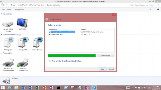

Here is an example
These two are the same printer
1- being shared by my Lenovo Desktop
2- Found by my Surface 2.

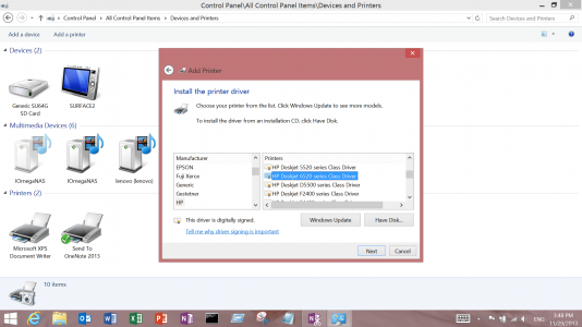

The driver was not found in the Surface and the closest one is this one

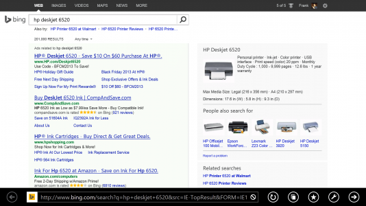

Which in Google search looks like the actual printer I have

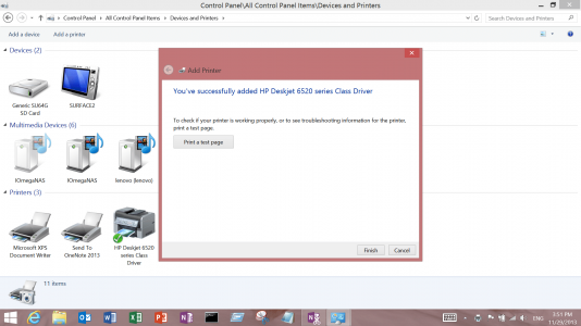

So, picked that one

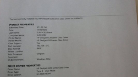

The drivers were installed, the test page printed ok
And here is the proof:
