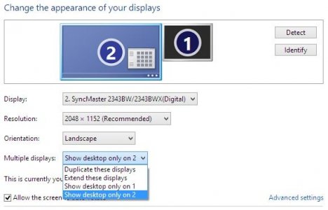

Sorry if it looks like Captain Obvious entering stage but it sounds like the setting for multiple Display is set to "Duplicate these displays"? What happens when you Switch to "Extend these displays" or "Show desktop only on X" where X is your Dell monitor?

As for getting 1920x1200, be sure that the display is set as EXTENDED, and not clone. Do Win+P on the Surface Pro 2 to switch between modes. You want to select the 3rd mode from the top called "Extend".
If that does not help, that is ok. That is the wonders of the suckyness of Intel integrated graphics. Nothing new. To fix this. Open the Windows Screen Resolution panel. and be sure to select your monitor on it, and then you should see 1920x1200 as option to select.
Thanks everyone! For some reason, I didn't see the option to change the resolution the first time around, after choosing the Extended mode. It's working just fine now. :)
