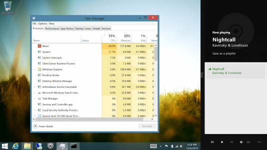

Playing an MP3 doesn't solve the problem -see attached- the music is just paused and quickly the 3 systems processes creep back up. disable hibernate altogether and just let your device sleep and you shouldn't get this issue since there's no cold booting. Screenshot (3).png
Playing an MP3 doesn't solve the problem -see attached- the music is just paused and quickly the 3 systems processes creep back up. disable hibernate altogether and just let your device sleep and you shouldn't get this issue since there's no cold booting. ...

Interesting. You've answered the question: playing audio files only transiently reduces CPU churning.

Playing an MP3 doesn't solve the problem -see attached- the music is just paused and quickly the 3 systems processes creep back up. disable hibernate altogether and just let your device sleep and you shouldn't get this issue since there's no cold booting. View attachment 1563
