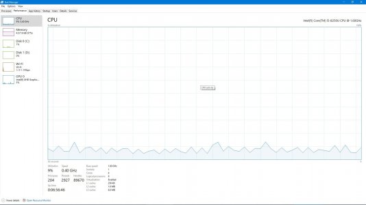

I'm stuck at 0.40
I'm still reading to see how to proceed!

A chat with Microsoft and a remote control session and a bunch of driver up dates and even a one hour memory check, and I'm still stuck at 0.40 Ghz.
