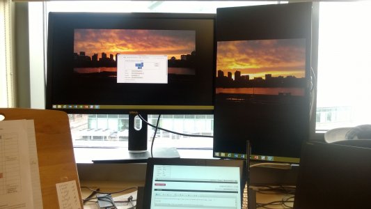

WP_20140120_11_07_01_Pro.jpgFinally, finally got this working. Setup is
Surface pro 2 connected to Dell u2414h via dp 1.2 cable, which is connected to dell 2713hm via dp 1.2 cable.
I have the 24" monitor in portrait mode (1920x1080) and the 27" in landscape mode (2560x1440).
Total cost (aside from SP2 was $300 for 24" monitor, $700 for 27" monitor, and about $50 for cables). Only wrinkle was that the dp 1.2 had to be "activated" on the u2414h via on-screen controls.

The possibility to use multiple monitors was a requirement from my side before choosing the Surface Pro 2 since I wanted to use it as my main work computer (previously I had one external 23" monitor and a laptop with 15.6" monitor). I looked at some Dell monitors (the only manufacturer I found that had monitors with DP 1.2 out?) and finally selected two Dell U2414H since it had a very attractive price (I had a somewhat tight budget). They also look really great since they have a very thin border!
I'm still awaiting the docking station and Type Cover 2 since they were out of stock, but the setup works anyway! (I will fix the cabling when my dock arrives! ;) )
I had some small problems (only happened two times so far) when resuming from sleep and the last monitor in the chain not wanting to receive any signal. A reboot of the Surface seems to fix that... Hoping that some driver update might fix that...
The monitors are nice since they have a USB 3.0 Hub so I have daisy chained the USB as well, giving me a total of 7 USB 3.0 ports that I use for headphones, iphone cable and wireless receievers for mouse and keyboard and so on!
