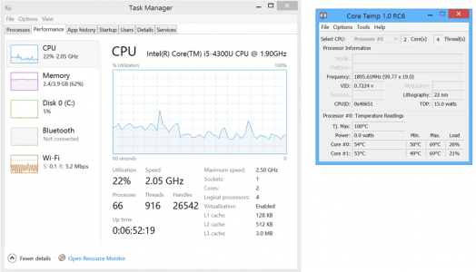

6) Thin body with less exhaust vents and a tiny "silent" fan means the device gets really really hot. I was running CoreTemp for about an hour during HDstreaming, CPU temperature was around mid 50'C, highest being 69'C. and this wasn't even a torture test. The device gets much hotter than the SP2 and while the fan doesn't turn on until higher temperatures than the SP2, once it gets going, it's got a really annoying pitch to it.
![streaming fHD.png streaming fHD.png](https://www.surfaceforums.net/data/attachments/1/1820-7f04ddfc0fd728d89d9b0ef13474c3cb.jpg)
