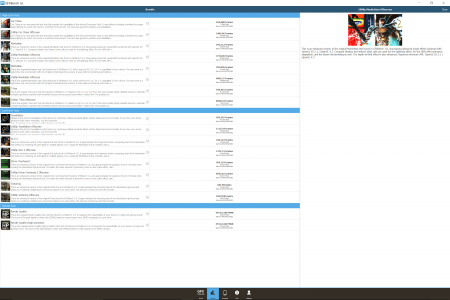

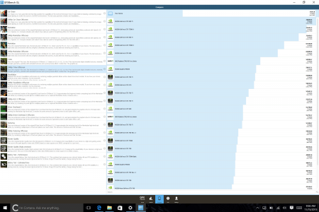

Well it very well may be zwifts problem but it is not just selecting the wrong GPU. If I detach the base and run, it gives acceptable performance. If I run with the base and ensure it is using the dGPU it runs at a third of the speed. With GFXBench the Tesselation score is much slower with the dGPU. Attached are the screen prints

I downloaded GfxBench and ran the tests. In the offscreen tests it seems to test as normal. The onscreen tests are way below what they should be. Given that my OpenGL game does run like crap with the dGPU it seems to indicate something is wrong.
Do I have a bum GPU?
Can someone look at the screen prints of the results and compare them to there SB? I need some proof that I have a bum GPU or not.

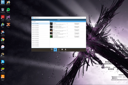

SB i7/16/512
