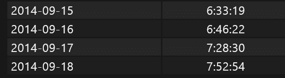

Quick update.
Didn't use chrome, undervolted a little bit, max frequency 70% in power saver plan
I'm glad with result.
But sometimes device stars heating because of windows defender, so what antivirus can you recommend?
