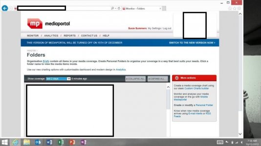

MY wife's accessing emails through mediaportal webpage. There is a pull down menu, it simply allows you to show coverage at various time increments, such as last 5mins, last 2 days etc. Once you select the option (highlighted) and click it or hit enter it should refresh the entire webpage and reflect these changes. IE10 on the Surface 2 is not doing this, nor the Metro version of IE10, nor the Desktop version. You highlight the change you want to make, click or hit enter and nothing happens... no thinking, no refreshing, its like it doesn't work, or that there it's waiting for you to hit an 'ok' button somewhere (but there isn't, the 'ok' button is left clicking the highlighted option).
On my desktop pc this works fine, both in IE10 and FF.
I was led to believe that the Surface 2 was running a full version of IE10, what's going on?
FYI once i select the option to display 'last 2 days' for example, then hit f5 to refresh page that doesn't work cuz its default is to show last 5mins coverage..

You see the pull down menu highlighted in blue. Once u select and click it should apply changes, it doesn't. I just does nothing. On a pc it does (using either IE or FF). Tried Desktop IE10 and Metro IE on the Surface 2, both behaved the same.
Apologies for perhaps going overkill with the white boxes covering up sensitive info (emails, url etc, cuz it's a work thing I just wanted to be sure).
I'm stumped, what possible reason would there be for using a pulldown menu in a webbrowser on Surface 2 result in non compliance. When i get a sec I might see if I can try a generic shopping website, see if i can find a pulldown menu and try there also, see if similar behaviour occurs.
