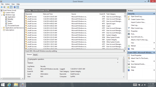

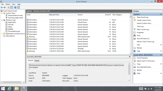

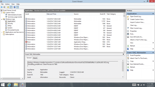

I don't know how to read these event logs but, as far as I can see, last night, I put it to sleep at 1:30'ish but then it woke up at 3:50 (where it should have been hibernating as it is set to hibernate after 60 min of inactivity on battery) and stayed on until I woke up and checked it at 5:55'ish. Attached are some views of the event log since I'm not sure which sections would be most important.
