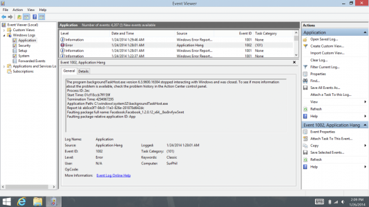

I don't know how to read these event logs but, as far as I can see, last night, I put it to sleep at 1:30'ish but then it woke up at 3:50 (where it should have been hibernating as it is set to hibernate after 60 min of inactivity on battery) and stayed on until I woke up and checked it at 5:55'ish. Attached are some views of the event log since I'm not sure which sections would be most important.
I'm not an expert, nor did I sleep at a Holiday Inn last night, but that first screenshot has a red ERROR at 1:28 AM that says application hang which I believe is a generic response for a program that has stopped responding. Try clicking on that error and see if it gives you the details below of the program that stopped responding. I'd bet that is the source of your Surface not going to hibernate, because this program is locked up and still running, preventing the hibernate. Kind of like when you try and power off a computer and you have that program that is not responding and Windows prompts you to wait for the program to respond or to force the shut down.
So this is what the event log says about that application hang:
Not sure how important that is.
