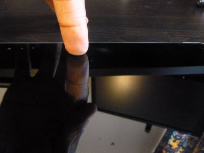

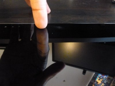

Just received my second Surface Pro 3 from the UK Microsoft Online Store and it has the same (minor) defect as the first one I got (and returned).
Was wondering if anyone else has this on their surface?
The screen in the top right corner isn't flush with the silver magnesium housing. You have to look at a (shallow) angle to see it but there is a clear issue. What's worse is that if you press down on this area, you can make it flush with housing again: see photos below.
I know this doesn't sound like the the biggest issue in the world but I'm concerned about how this issue could develop over time.

Thanks for your reply, but no, this is not where the speaker cut out is, its on the other edge, (see photo below):
ok it was hard to tell from your first pics and the fact that you mentioned upper right, thanks for clarifying that... no mine is definitely flush and flat... but upon investigating it whn I press down and slide my finger it does kinda catch the edge.. when you DON"T press down and slide your finger does it feel nice a flush? mine only doesn't feel flush when I press down... but in no way it is a defect.
Sorry, should have put up better photos but its really hard to get a (cheap) camera to focus on a very reflective surface (...no pun intended).

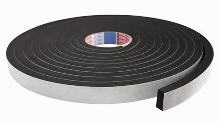

But where there is the plastic part (camera side of the sp3), I wonder if they use the same glue as the one they use to stick the screen on the metallic frame.
I've repaired a few iPad broken screen (my girlfriend has the bad habit of dropping her iPad) and instead of using real glue, they use a kind of foam tape, that is not 100% stiff.
But as the screen of the iPad is embedded in the frame, you cannot notice anything, even if you press the screen on the edges.
My suggestion is that maybe Microsoft uses this kind of tape on the plastic side of the SP3 (maybe for a chemical reason -- epoxy glue being able to dissolve the plastic ?). And then, when you press the screen, it feels flush, not because it's unglued, but because the foam tape is a little elastic in its transversal section.
So maybe, it is not a defect at all.
