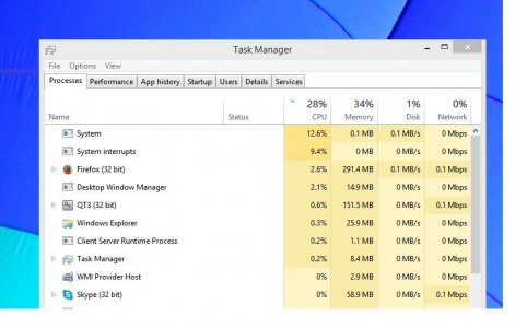

don't know if you consider off topic but today I had another issue, read here
with the Sp3 connect to the docking I get in task manager 20/25% cpu overload for nothing just for system and system interrupts .... I googled and found many users with same issue, one of them removed the sp3 on the docking and solved... even for me worked only in that way. Scaring! I need to solve even this issue now and this will kill me to use at all the docking... I'm with the up hands... what to do......? thanks for help.
http://www.surfaceforums.net/threads/sp3-system-and-system-interrups-waste-20-25-cpu-heating.11018/
