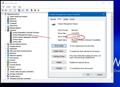

Ahh that interesting, the MSI version was not available yesterday when I downloaded the files, only the zip file. I will give the msi a try now
Here is what I do - I click on the install file, and even if it says they are installed - I uninstall, reboot, re-install just to make sure I got them. This is what mine looks like after the install. I hope this helps.
