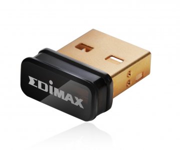

If you are really having a tough time just go on Amazon and get one of the tiny USB wifi adapters they sell there ($10). Will bypass Marvell completely.
Amazon.com: Edimax EW-7811Un 150 Mbps Wireless 11n Nano Size USB Adapter with EZmax Setup Wizard: Computers & Accessories
