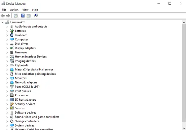

I followed the steps from the link but my tablet lacks a touch controller firmware listing.
Mine has the following firmware listed:
Firmware Resource
Surface Pro Embedded Controller Firmware
Surface Pro System Aggregator Firmware
Surface Pro UEFI
I have a single "other devices" listing for cover trackpad. I don't have any devices that are unknown or that have a yellow exclamation on them.
