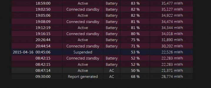

I've read through many of the posts on battery drain but I'm still at a loss on why I'm having this issue
I put my Pro3 in standby when I go to bed and often anything between 11-18% battery drain overnight. Understand after 4 hrs it goes into hibernation so i'm losing 18% battery in 4 hrs!!!
I've checked mail in on manual sync and I have turned off live tiles but this still occurrs. I've ran the powercfg reports but I'm not sure what I'm looking for. Can anyone offer any advice / guidance

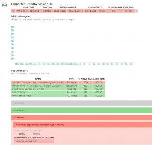

Your sleep study shows the USB 3.0 port being active. Do you have a dongle or something connected to it?
No dongle...no usb connected device. I'm wondering if a reset to defaults is worth it but I have it configured with software exactly how I want it and concerned I'll get the same issue again.
I did wonder if it could be bluetooth related but this controller is USB as you say
Have you used a USB device and installed its specific driver? If so, I would delete them and check sleep performance. If everything seems ok, reinstall the drivers one by one until your problem reappears so you can pinpoint which driver is at fault.
thanks for the advice
only usb. devices I've connected are printer mouse and usb stick
but they don't stay connected in standby
ill remove the devices and see how it goes
thanks
The devices don't need to be constantly plugged in to the USB port for it to be awake if the driver is corrupt or incompatible with it. Go to Device manager and delete the device driver and then delete the device itself just to make sure that it doesn't do an automatic driver update. Reboot and then check your sleep performance.
