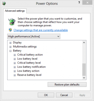

What are your Power options for Battery?
Perhaps something was inadvertently set to something ridiculous?
I agree with JP that a cell cycle wouldn't hurt, but that seems hard since you are getting a power off when you unplug it. Check your power settings and try changing the settings back to balanced and then select defaults. Have you done a full reset on the device yet? I do not have enough information to know if this appears to be a hardware issue for sure or if its the result of software acting wonky.
I have change the battery options a few different ways with no success. I have also reset the tablet to factory settings. The battery must just be dodgy. Gonna be a lot of effort sending it back, but we shall see how painless/ful this will be.
