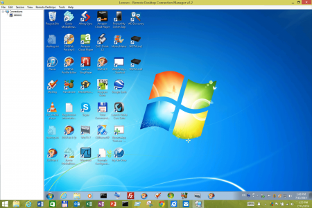

Try Remote Desktop Manager
http://www.microsoft.com/en-us/download/details.aspx?id=21101
I don't have any problems with Remote Desktop.
That app works!! Thank you. But what gives? I like the modern one better though. If I can connect using that app why can't I connect using any of the other remote desktop apps. This is driving me nuts.
