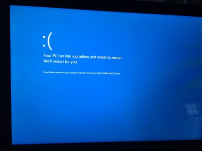

Reset the surface tonight whilst I was having dinner I've returned to my surface and found this screen and its constantly rebooting now:(
Remove your SD card.
Thanks, but no SD card in there...
I managed enough of a reset to make the monitors work off the dock, so my immediate issue is fixed now. Would rather know I had the usb boot option for the future though.

Decided to "reset" to a clean Windows 10, kept getting an "inaccessible boot device", surface would reboot twice, then revert back with no changes made.
I'm thinking, maybe bitlocker had something to do with it. So I turn bitlocker off. Now it jest went into a "inaccessible boot device" loop.
Had to re-image to 8.1 and then upgrade to 10 again... half a day...
