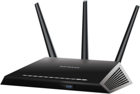

With the Marvell Chipset, the easiest fix is to remove any Router QoS settings. I replaced my Belkin N750 Dual Band with the Netgear R7000 AC Router and I'm loving it.
I was not aware that the surface Pro 2 or surface 2 was capable of 802.11ac protocol? Are you using a USB wireless receiver?
Nope....it is only "N" but when I upgrade my Router I want it to last 3-5 years so I will have AC at some point. But in all seriousness it has some of the best "N" throughput of any of the router I've used....

Gawd I want that Netgear R7000 router!
I did end up picking this up.... THANKS jnjroach :X
I got it in November couple weeks after I posted this.. Seems fast, I don't get full bars on 5GHZ 35ft away from the router but then again none of my routers have. It seems I get some weird interference in this house.
I have had to reboot it once since owning because connections on all our devices weren't connecting. There had been a firmware update and it seems okay since then.
Crazy thing is I went to purchase it at best buy and it was on sale for 179.99 but wasn't marked. So it was a nice little surprise at the checkout
