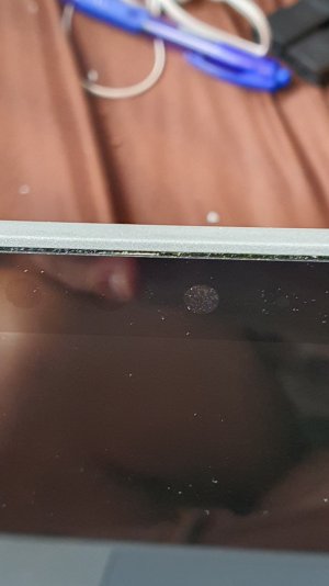

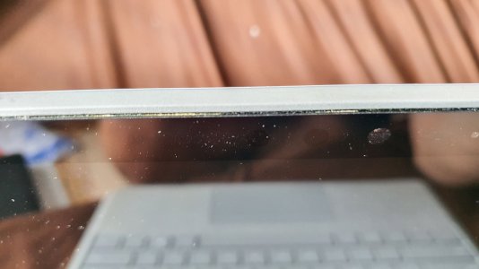

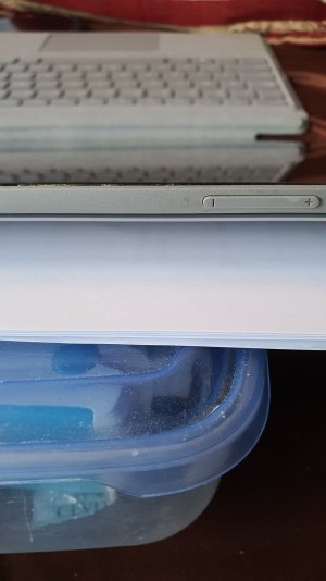

Hi guys.
I purchased this tablet in used condition from a guy claiming nothing wrong is with it.
While I was cleaning the tablet I noticed this (pics) at the top edge of the tablet.It is barely visible,maybe crack is like 1mm wide or so, and I can see probably yellow glue stains.
Now I read about all nasty stuff about battery bulging and causing screen to separate on Surface Pro 4.
Is that even in my case?
Or someone replaced the screen,and didn't use a proper glue.
Gosh,it just made me depressed and worried even more,cuz I'm perfectionist (OCD).
Yeah I know this thing is 5 years old,yeah I know it has issues with battery but then again I love the design and wanted to have it.
Battery wear level is 13 %,I mean that is not that bad.
I know to keep my things in good shape,my tablets last me even 8 years.
So I suppose I need to take some precautions about this battery just to try to slow thig "bulging" down.
Can send battery report file,if someone wants to check up on battery.

you might ask the seller IF the device had been opened or screen replaced.
From the pic I'd guess it was opened and it's just the fit of the work done ... unfortunately there's no way to tell what the future holds. If it stays the same, no harm but if it's growing wider then it's the battery swelling. You'd have to consider your options, to keep or return (if possible).

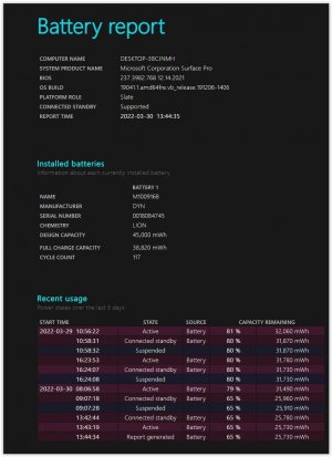

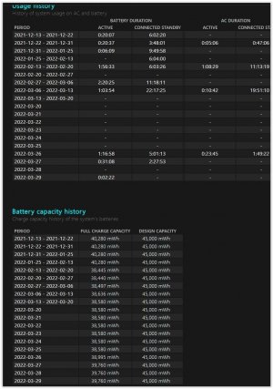

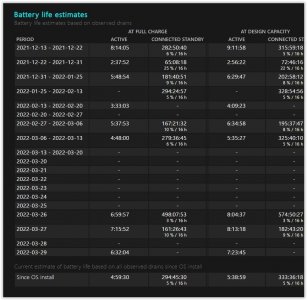

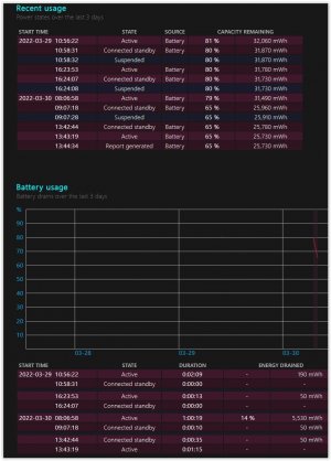

I'm sending below battery status report,I mean it ain't that bad.

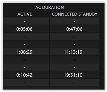

Last pic as I see he kept laptop on a charger for 11h and 19 h which is not good at all.

battery swelling is a phenomenon of the material it's made from ... there's no set pattern that says the battery will fail after X, Y, or Z cycles ... it just happens. Normal battery care is the best you can do, don't let it discharge completely, and don't press on it.
I'm guessing it has not been opened then ...

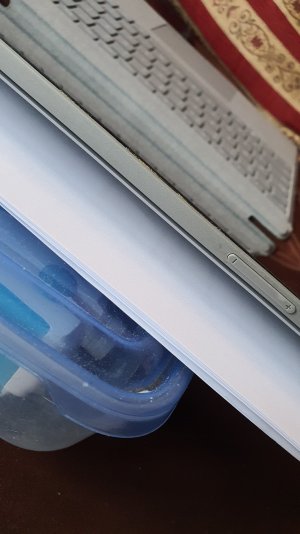

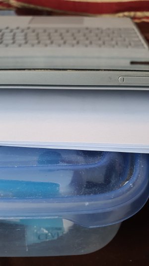

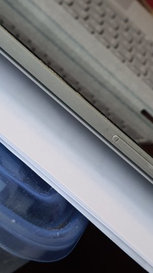

If the battery is swelling and the edge is pulling up I would think the center should be bulging out even more. If you look horizontally across the screen does the screen look like it's bulging? Or lay it on its face, is it lying flat or rock at the edges?
AFAIK once it is swelling you can not stop it. It's like a waterfall made of molasses, it's going to progress slowly.

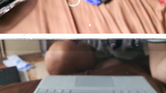

I am afraid yes...it is bulging horizontal for like 2 inches in length..it is small gap but noticeable (look at the pics) (2mm at most).
Gosh I was such a fool,but ordered not even seeing it.
So not using it or rarely using it won't make the Surface I mean battery last longer?
Would rarely using it,I mean like charging it once per week,reduce total disfunction of the device?

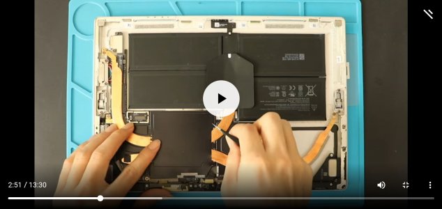

Isn't it logic to buldge on the bottom edge of Surface, where connector for keyboard is, since on that part battery is placed (look at the video)?
My bottom edge is perfectly flat as on the sides.
My model is 1796.
Simple google gave me deformity at sides of Surface which I don't have.
I think you are right.
Someone probably didn't glue screen properly after work (top edge of Surface).
There is no logic for top part of Surface to buldge if the battery is the cause in my case.

when I looked at the pictures before, because I found the pictures disorienting, I only focused on the crack, not the location.
the top edge has a plastic piece covering the antenna bay. it may not be a problem at all if it's just a lousy glue job.
To improve the appearance you might try to scrape/clean out the crack with a guitar pick or some similar small tool being very careful of course.
